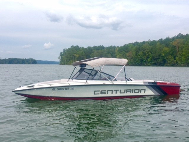

Here's a pic of my 1993 open bow Falcon.

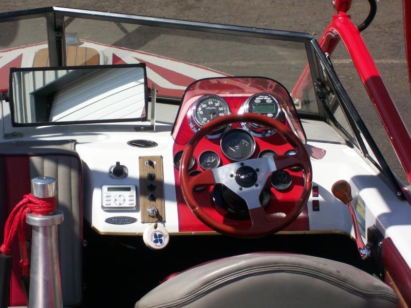

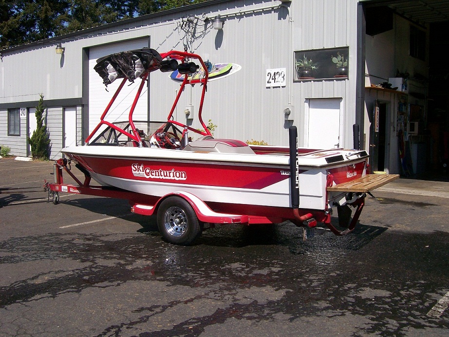

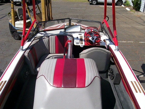

h20king    795

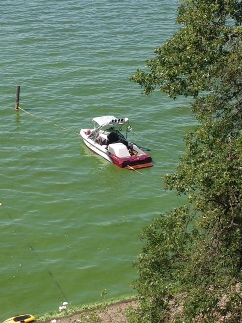

post-777-0-99319500-1422585808_thumb.jpgpost-777-0-92593800-1422585691_thumb.jpgpics of our 84 tru trac from back in the day
quick question for the falcon thread what size packing for the stuffing box for the drive shaft   93 falcon open bow with 351 dd

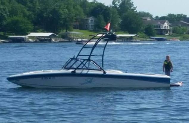

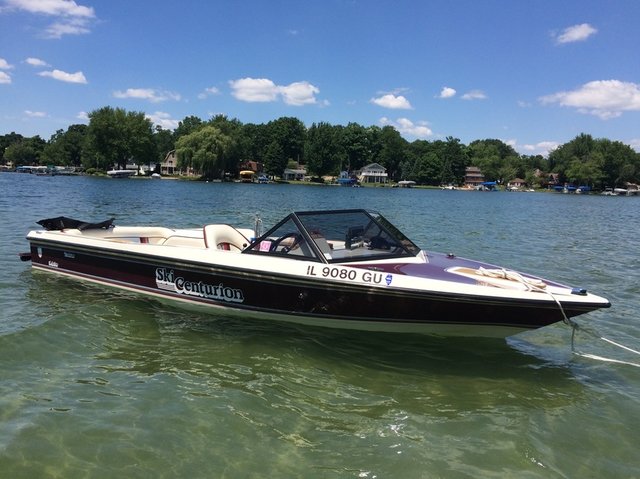

Here is my 1986 Tru-Trac

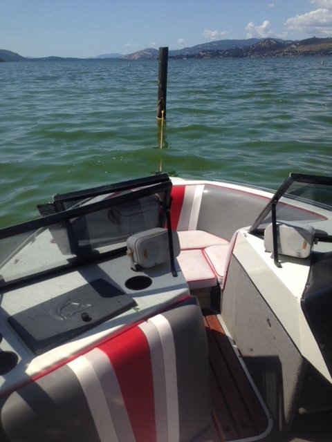

Im not sure I belong in this thread.  I just go a '95 Heritage.  I can't find much about it but I am assuming it is in the Falcon/ Tru-Trac family.  Anyone else on here have one of these?
86SKI    12
Nice boat JimbolA. You have a Falcon. I believe that the "heritage" designation regards to the paint scheme/logo as compared to the regular Falcon (first picture in this thread).
JimboIA    0
H20King I see you have a surfboard in the rack in your picture.  Were you able to get any kind of wave to surf?  I haven't even tried yet but It seems like it might not be doable.
Timr71    12
The Heritage is a trim package that was available in 1995. The hull is a Falcon variation that matched the Falcon Sport from that same year.  There was also a LaPoint, that was done in conjunction with pro skier Bob LaPoint.
