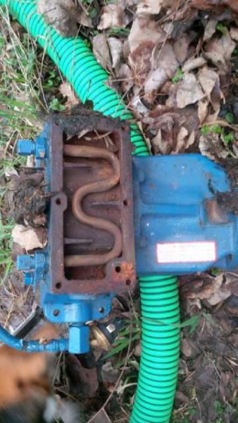

I winterized my mercruiser 350 mag mpi as mentioned in the owners manual, I pulled the blue plugs and filled with rv antifeeze. No where did it state to drain trasmission or v drive? Am i screwed? Im headed to the lake this weekend but scared that something in the v drive or transmission could have freeze damage. Im hoping these units are somewhat self draining.

I've never winterized a boat in my life (doesn't get cold enough here), but I do know that water expands when it freezes and oil and transmission fluid do not. That is why you don't really need to "winterize" your V-drive or tranny because the only fluid in them is fluid that does not expand with cold temperatures (at least not appreciably). Only problem I could see is if you got water inside the tranny or V-drive but then you'd already be screwed before the cold hit.
You should be just fine
dremmick    0
The v drive does have a water chamber on top that has an oil cooling line running through it.So bassically it acts as heat exhanger. Im worried this chamber was filled with water and froze.
That's a Walter box? So the water chamber cools that oil pipe that's in a loop?
dremmick    0
you are correct
