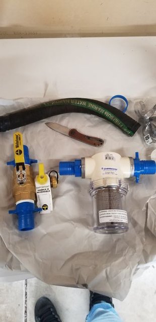

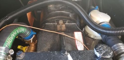

I did the fake a lake for awhile and got tired of it.  Sometimes if enough water drains out of the system the impeller isnt primed and the fake a lake struggles.  Heres what I did. You can see the valve to connect the garden hose on between the intake and the vdrive.  Ive got a thread on here that has the link to buy the valve.  When using the fake a lake I have had to disconnect the water hose from the vdrive, fill with water, reconnect, then hook up fake a lake, this primes the impeller.  You might try that.  Chris
