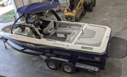

Hey Crew,
I'm looking at a 06 Centurion 23' Typhoon but wanted a little feedback on surfability. I noticed that it has the exhaust out the side, does that actually help, or does it just waft around? It has built in ballast, and a "manual" center trim tab...  All in all the boat is very clean, low hours, and well maintained- however we'd  be looking to pick up this boat to primarily to surf... maybe the occasional ski but primarily surf. Thoughts? What if anything would i need to add to enhance it? (links/prices) if so...

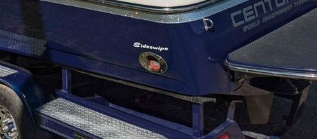

the exhaust is referred to as "sideswipe."  i converted mine to a single exhaust in the rear (link here), and Fresh Air Exhaust also offers conversion kits.  most sideswipe valves have broken by now on these, and it's more expensive to replace both actuators than it would be to convert to FAE.  if you don't mind the exhaust sound you could just leave it, but it gets loud at cruising speeds.

62b0d466670bd_ScreenShot2022-06-20at3_10_58PM.png.0f28309783ab6ad57cd30f831a03d693.pngI’m pretty sure after messaging with Troy it’s the deep v of the later models, … it definitely doesn’t have the big chunk cut outs in the under hull. But my wife and I went for a test ride yesterday and couldn’t believe how loud the side swipe exhaust was… we absolutely loved the boat everything else was amazing and super clean…. But we do a lot of puttin’ to dinner with guests as well as water sports and it was so loud….
I saw JTyron step by step guide to a thru the hull guide to FAE… I’ve also see a few posts on Installing quiet tips - I guess this is the old orange tip sideswipe model???
I’ve also seen there may be a muffler option from www.GGG.ca, but not sure if that is still a thing?

Also it’s a 2006 23’ typhoon but the late year model with the deeper-v hull w/o the cut outs and the c 4 wrap around seating…
