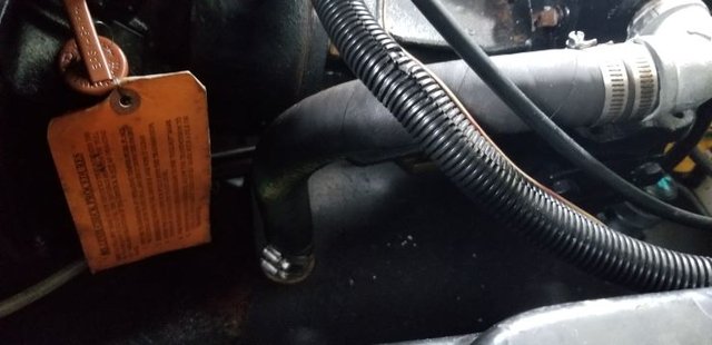

Alright days are getting a little longer, chickens are starting to lay eggs again, sun is shinning, almost time to hit the lake.  Ha, who am I kidding its still January.  But the sun was shinning on Saturday and got this accomplished.
Before
Chris O    14
Done
Just wasnt room to fit it all between the intake and the v-drive.
I have no idea what kind of fittings these blue fittings are, but they seem strong enough and this is all under low pressure.
https://www.supplyhouse.com/sh/control/product/~product_id=40615
https://www.amazon.com/Seawater-Strainer-1-1-4-inch/dp/B000N9Q3MM/ref=sr_1_23?crid=4OK9BARHP18Z&keywords=SHERWOOD+SEA+STRAINER+1.25"+Item+%23%3ASHE18016&qid=1642621271&sprefix=sherwood+sea+strainer+1.25+item+she18016%2Caps%2C118&sr=8-23

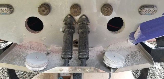

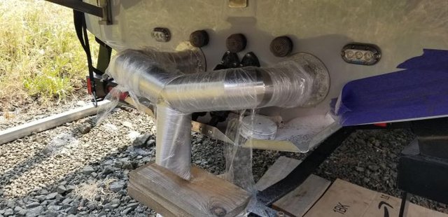

Chris, I love the way your FAE turned out. I am in the process of ordering one right now,, just got my email order confirmation. It looks like you don't have any other support bars on the FAE with the way yours is mounted?  I really like this look. I saw another thread Here that they removed the stock black muffler rings. Need to talk to FAE and see If I can copy this setup.

Chris O    14
Avy06,
Yeah, no other support, its got machine bolts and 3M 5200, its super solid.
When your putting everything together on the inside make sure youve got enough room to get to your impeller.
I didnt give myself enough and to change my impeller I've got to remove a portion of the exhaust.
Ive been real happy with it.
Chris
Chris O    14
Seattle996,
The flushing and strainer setup has been great.  Although any lake I've been in has been pretty clean.  No leaks, no change in water flow to impeller that I can tell.
I wouldve liked to get the strainer before the vdrive but there just wasnt enough room.
Makes winterizing and dewinterizing way easier.
Chris
