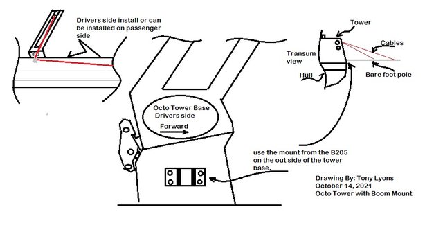

twlyons1    0
Iam planning to use that mount for supporting partially a ski boom to help teach our daughter and friends how to ski on boards and ?? feet, butt, table---lol
The Octo base has a very solid thick mount that is hollow ,and a simple mount can be put in the middle of that area on the out side of boat area of it, put a 1 1/2" ss 14 Ga. tube 10' with a single pin with a 1/8 ss cable down near the 9' area outer end plus with eyelet for a climbers D-Ring and threaded eyelet in that mount above on the towers  ,,, run another forward to the boats bow eye with an ample noodle for protection of hull,.
I have sent in the idea to Lane 'Dawg' Bowers and Barefoot ... considering the Octo Tower has no mounts designed for it,, other than putting a pole/ Boom across the entire boat then out for the student person to learn. . There is no mount or plan with them other than drilling 8 holes in the gunnel--on the 2018 S238 --nnooppe - not gonna happen,, 4 holes on the out side of the Octo base and if mount ever removed--4 rubber plugs for 5/16 holes ...... They will have to be looking for it to find it :) situation.
