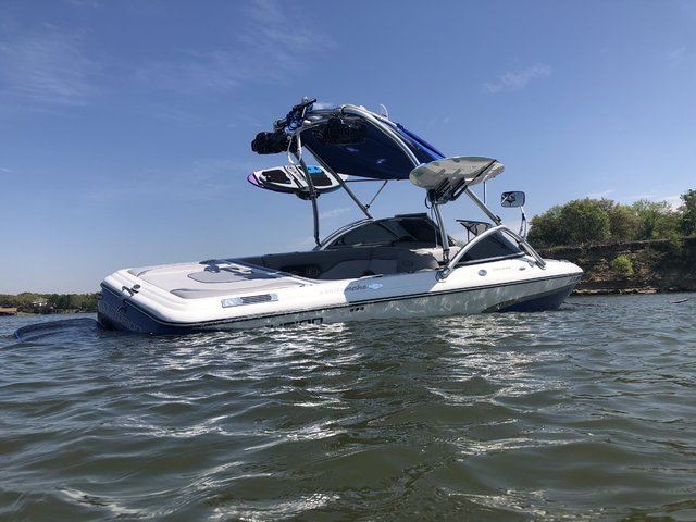

Yes. List = lean over to one side.
I included a picture of mine listed. Little less than normal because we are resting but you get the picture. Lead is good, I trailer mine all them time so I like the water weight. Empty and go home. I don’t haul around all the extra weight all the time. To list, you need to practice driving and be very aware of your surroundings! When the surfer falls. Bring throttle back to neutral while turning hard to opposite side of the wave. The wave will ouch the back of the boat around and you can drive right back to the surfer. Practice this and you will get the hang of it.
