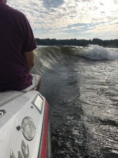

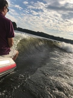

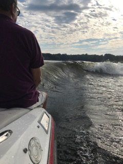

I absolutely love reading these threads. There are great arguments for both sides and either one makes for a compelling argument. I'm a huge advocate for the refinishing of the boat you currently own. Remove those stock tanks, plumb in some 1100lb sacs in the v drive lockers, grab a suck gate, and make an appointment for the dentist because your jaw will drop. Seeing an old beauty throw a nasty curl in my opinion is a force to be reckoned with with all the new boats out there.
That being said, who doesn't like new? Flashy, new tech, easy wave set up. They are incredible machines and make setting up a great wave a breeze. Plus they look amazing in the water. However with your situation (riding 10 times a year) I'd keep what you have, throw on some upgrades, and watch how far that gets you. Lots of awesome people on this site have solid DIY projects on their boats and their results speak for themselves. But at the end of the day, it's your cash so you do what ever makes you happy my friend!
Just threw some pictures of our old 06 avys wave for giggles. Viva la shred.
IMG_3433.jpg.b02351956824470b6c593aa5b8b5ad01.jpg IMG_3427.jpg.06046a8a3ee05f1d2562d3d956b4b49f.jpg
