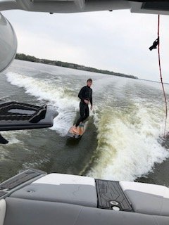

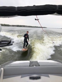

Quicklaunch and Quicksurf are engaged. Only a couple pics to share, which dont do the wave justice. Will find out more about the wave on this baby next weekend and will share.

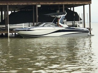

Very nice vessel Zeej2020!!!  I love the "battleship gray" especially in the sun on the water and inside the boat.  Along with the purple, I have received many compliments on the gray.  When we surf with a couple to 3 people, we did try out that 400lb in the transom, with ramfill and PNP full and it made a great wave.  Try without water in the front center tank and adjust with more stinger 65-90.  That was a good wave too.  Without the weight in the front center tank you get a  tall wave, with few peeps.   With more people, we can move the lead weight forward (100 mid ship, and 100 in front of PNP, 200 in transom) and keep the attitude of the boat where the wave is just big (see pic).  That goofy wave is steep enough to go over your bow.
What setting are you using for the quicksurf?  I was told to be careful using the quick launch and quick surf at the same time.  They said it confuses the computer and the tabs could freeze up because of the freezing of the computer.  It did happen to us once.  We had to reboot the system.  Thank you for sharing and send more pics for sure.
I sure hope I can get a cleaner wake than this or I am going to be disappointed. Hurry up and get it figured out so I have a good place to start LOL

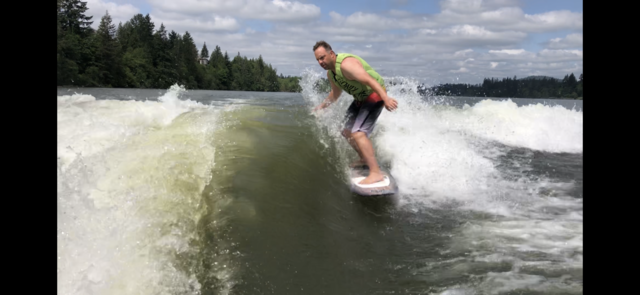

Not sure what ballast you got with your boat but here is the set up I got from Gerry Opplinger our centurion regional sales manager.  This set up is for regular.
Quick surf 75 - 0  center trim at 35 ,bow sack at 50 ,center tank at 100 , ramfil  100- 96 ,PNP 100 ,transom  at 100 and speed at 11.4
Fivebar2    176
Here is the wave that H20king is referring to. The wave was $$
Was that at lacamus? If so what was the water temperature? Thinking about dropping in there Sunday.
