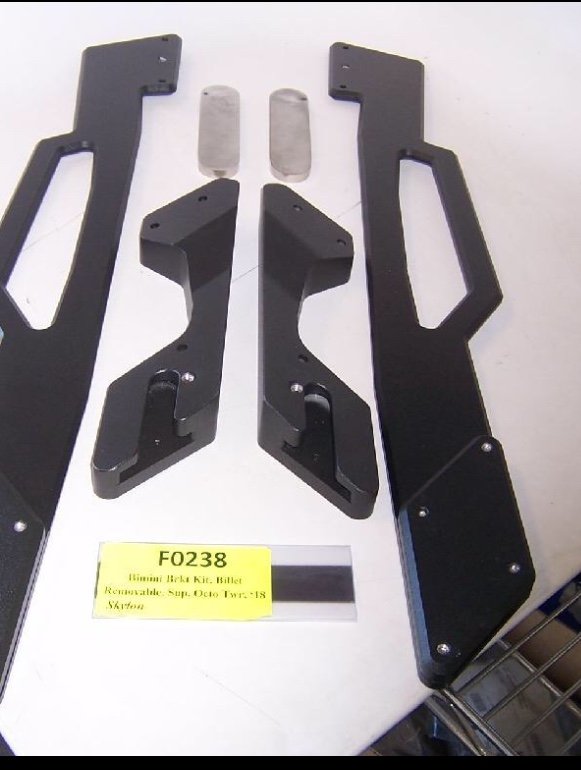

There has been a new Bimini arm bracket kit that was made for the Octo tower. The part number is F0238. Dose it let you fold the tower down all the way ?
mfenton2    2
I just bought a 17 s238 last week with this kit on the tower. You can fold the tower down but you have to pull the right bracket in at the same time the tower is coming down so it doesn't hit the throttle. When tower is down the left arm is about 1 inch from the love seat. Cant fold the tower down with the cover on also.  Im going to do some research to see if  I can make it where you can get those arms off with some pins of some sort.

ruffing    0
Good morning,
There has been a new Bimini arm bracket kit that was made for the Octo tower. The part number is F0238. You can call your selling dealer for pricing. Happy Friday!!

Does anybody have a pic of the updated brackets installed. I just found the parts wrapped up in my bimini on my new boat, but no instructions on how it goes together.
I figured out how they go on.  Without the bimini brackets on the tower, my tower folds to it's lowest point to where it is supported by the tower cables without any issue.  Both the old style, and new style bimini tower brackets contact the windshield where they attach to the tower so I don't see a great fix here except taking the bimini off is easier to do as long as you have two people.  I wouldn't spend the money on replacing the old style.
