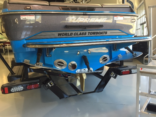

Compare the hulls of the s238, 217, 237 and 257...if you can find a lick of difference in their shape on the bottom you have a much keener eye than me. I've been staring at them right next to each other at the boat show all weekend. In particular the 238 and 237 look dead on to me below the waterline.

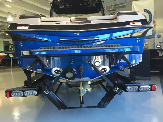

First I absolutely agree that an S238 can put out a GREAT wave. However, in order to get there you are GROSSLY overweighting (I personally view the plaque as a guidelines not an actual rule).you are also using up all available storage, etc.
Now as for pure hull differences. Notice RI237 is angular all the way from Stinger to the side, the S238 flattens out the last few inches. I am also willing to bet the angle is different,
Now look at RI257, the surf tabs flatten, and change angle within the tab. Due to hull changing.
So similar I agree, but small differences can be huge.

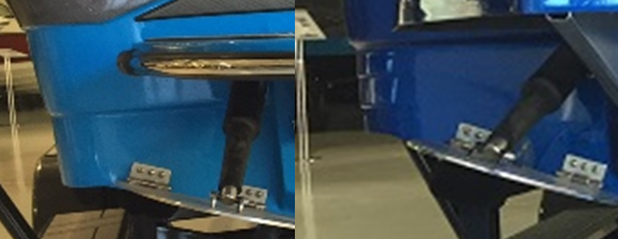

and...
Zoom in on corners, significantly different

This is what I am referencing. Maybe this is minor maybe it isn't.
